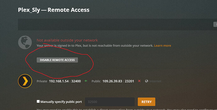

Some remote access stopped working
ok i’m doing it right now
@ChuckPa
Here’s the log .
Before you tried to reset, I had disconnected from remote acces before I shut down the sevrer. That’s peraps why you didn’t see a certifcat ?
Plex Media Server Logs_2020-10-05_18-18-11.zip (1.9 MB)
Here is the time settings in windows
@yevaman44
Your machine now has a certificate

It has this error from Plex.tv

I just restarted and can use the server from my mobile device, but https://app.plex.tv/desktop#!/settings/web/general still shows “unable to connect to XXXX” in the sidebar
