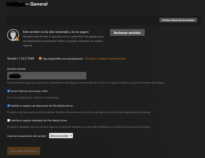

Same problem.
I update to the latest version of your website and claim the server but there is no way. Uninstall, reinstall…
Revised router and firewall of the nas (Qnap)
If i click in “log in” i will go to the first picture here and i can’t claim the server.
I have solved it… thanks
