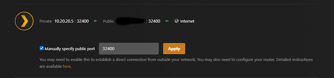

Suddenly no remote access

However, I’m still unable to create a direct connection.
What can I do to fix this?

Hi all!
Having same problem…everything was working and now i can’t remote access plex server.
Plex is showing that everything is fine…restarted router/docker - noting changed.
I’m running plex in docker container on unraid.
Thank You

Tried force stop and clear cache on the app…Nothing…It works fine while i’m on the same network as plex server but as soon as I go on mobile server disappears
Plex.tv comes through your WAN IP address (modem/router + port forwarding + firewall )
If Plex.tv can reach your server (the WAN IP:port) then so should the app … because plex.tv gave it that same IP:port)

OK…It seems to be the problem with my pixel 6 phone…on other devices remote access works…Weird.
Thank You very much everyone
