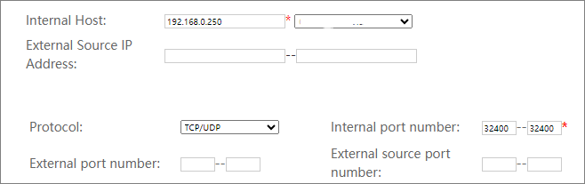

Are you certain your modem/router is forwarding port 32400/TCP to 192.168.0.250 (Synology IP)
Yes sir, screenshot as below. If certificate is ok, i will try to troubleshoot again, thank you Sir.
I did a ncat <your WAN IP> and received a timeout.
Connection timed out.
I can run mtr to your router without issue.
I just had a chance to look at your port forwarding: (sorry. the hour is late)
  1. Protocol – TCP
  2. External port number: 32400 - 32400
  3. Internal port number: 32400 - 32400
You forgot the WAN port.\
If you want to change the external port, that’s ok.
Whichever port you assign is what you tell PMS as the port number to use.
