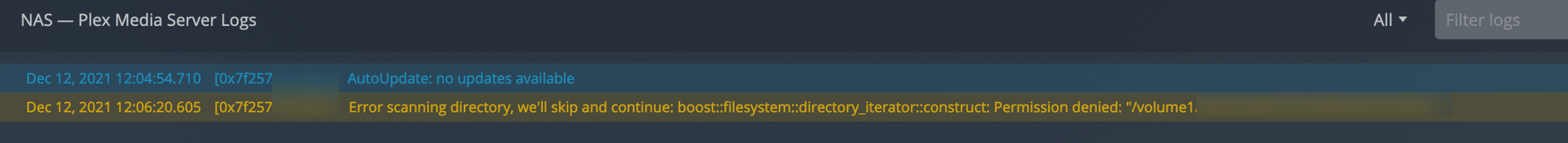

Synology 218+ Plex error scanning directory "Permission denied" despite having read/write access
Server Version#: 1.25.1.5286
DSM: 7.0.1
Server log says: Error scanning directory, we'll skip and continue: boost:filesystem:directory_iterator::construct: Permission denied "/volume1/sharedfolder/path/to/file

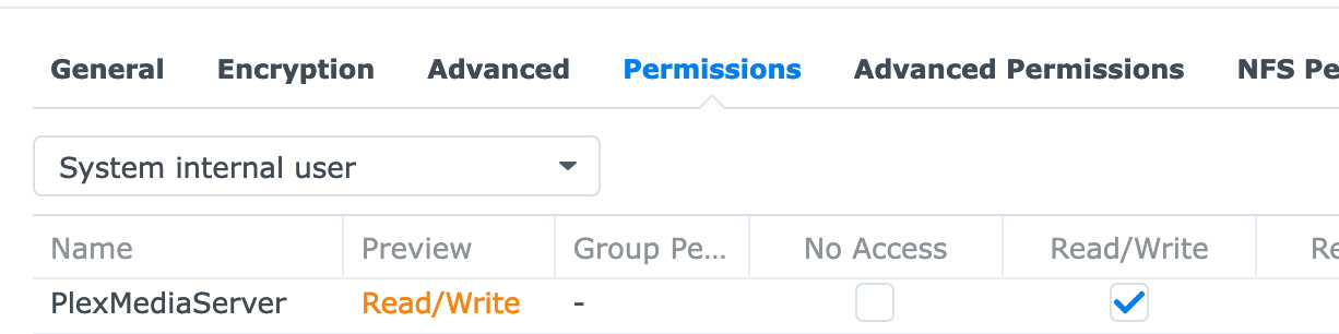

I understand permission denied, but am unsure why that would be the case, since for the shared folder > Permissions > System internal user > PlexMediaServer has Read/Write access.
Any idea how to fix this or what is going wrong?

Perform a recursive permissions application of the share.
Hi Chuck, thanks for taking the time to send a reply on a weekend - much appreciated. So I removed read permission and re-added them while having checkbox to apply setting to subfolders ticked.
Took a while but did the trick. Thank you.
