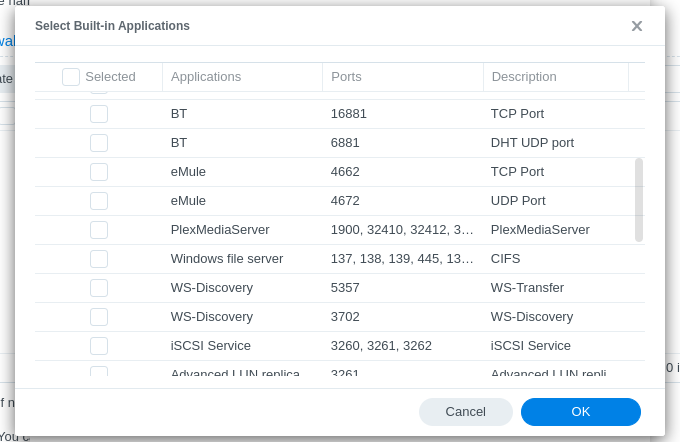

So for my BIG question :slight_smile:
What makes it show up in Control Panel - Security - Firewall - (select)
e.g. This list
I presume this is why we’re fixing it?
You wrote a little incorrectly where. Yes, and this too, if Plex is not there, then the port config did not work.
it should be something like this

You’re allowing UDP+TCP on those ports.
That’s not the spec here. I have TCP-only and UDP-only ports.
I can get this (UDP) or the TCP ports but not both:
Screenshot from 2023-09-12 16-39-10
Then I don’t know, I reviewed a lot of Synology services. They always use TCP and UDP for the same port.
They point this out explicitly in their GitBook.
Required
Each service should have destination ports. The value should contain at least the port numbers, and a default protocol that is tcp + udp.
It’s up to you to decide what to do. Have a nice day, it’s already night for me. :slightly_smiling_face:
@vladlenas
ALL following here:
I’ve found a way to implement predefined firewall rules for PMS. It’s not pretty.
This is the only way which works on DSM 7 without knowing DSM 7 internals & documentation.
Is this acceptable ? (TCP & UDP settings for the firewall)
Why It’s not pretty? Look above, the same method is used by Download Station.
I think it’s a great job on your part, all minor bugs are now fixed. :+1:
This is what I found, everything is in the Sinology documentation.
Usually a package only has one unique service name. If your package needs more than one port description, you can define service_name2, service_name3, …
