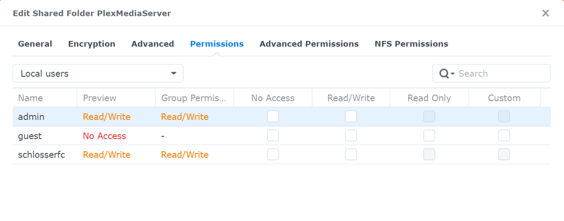

This is the window that comes up…
But, when I follow the instructions, I can’t set the permissions…
Because the PlexMediaServer user is not in the list.

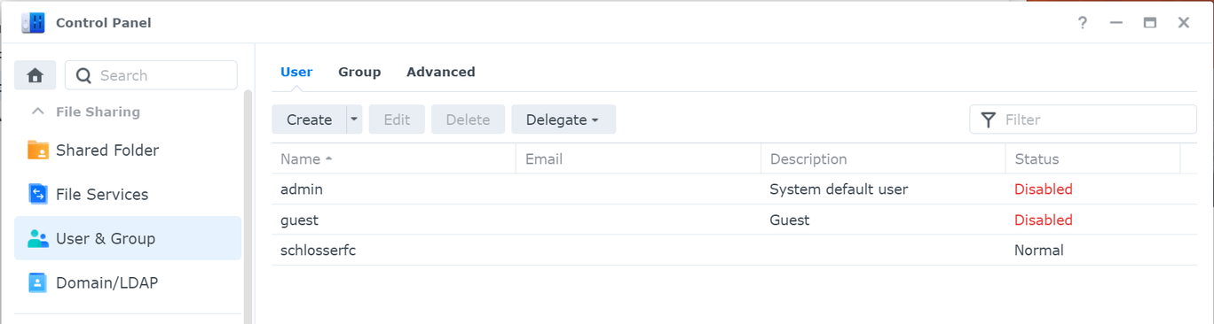

If I go to Control Panel/User & Group and try to create the PlexMediaServer user, it says “The user name already exists or is reserved for system use only. Please enter a different one.”
When I go to File Station and right click on the PlexMediaServer share and select Permissions, then the PlexMediaServer user is there with Read/Write permissions.
I have no control over the PlexMediaServer user as it does not appear in the User & Group dialogue
Not Local User
Change that dropdown to System Internal User.
