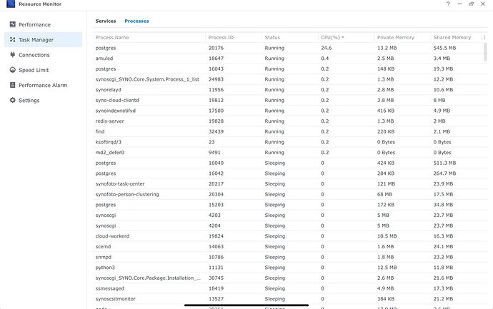

Thanks for the instructions, but there is no PlexMediaServer activity going in in “Processes” as the file is being installed. Is that normal?
Cheers
Cheers
Wait for it.
Do not migrate away from that page in that tab.
You will always get a result if you stay right there and wait.
Got the following message pop up, this is what happened all the previous times.
There is no sign of PlexMediaServer activity in Resource Manager
Welcome to DSM 7 ![]()
Let it run

Starting to think I should have stuck with DSM 6 ![]()

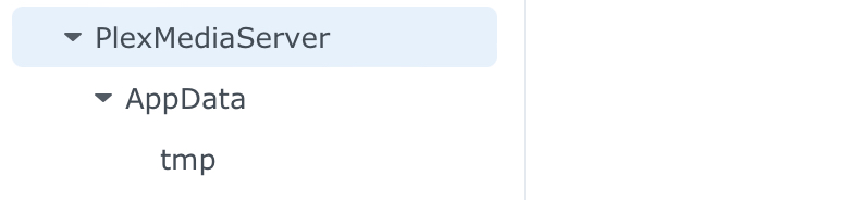

Just out of interest I looked in the PlexMediaServer file location and just two folders and all empty. Not sure if that is significant.
Unfortunately I am not tech savvy enough to do the script you mentioned so I’ll put my feet up and open a beer for a while ![]()
Let it go… It’s getting there.
When these are created… It’s about to start moving the data.
Do you see ‘Migration.log’ in the Plex shared folder ?
