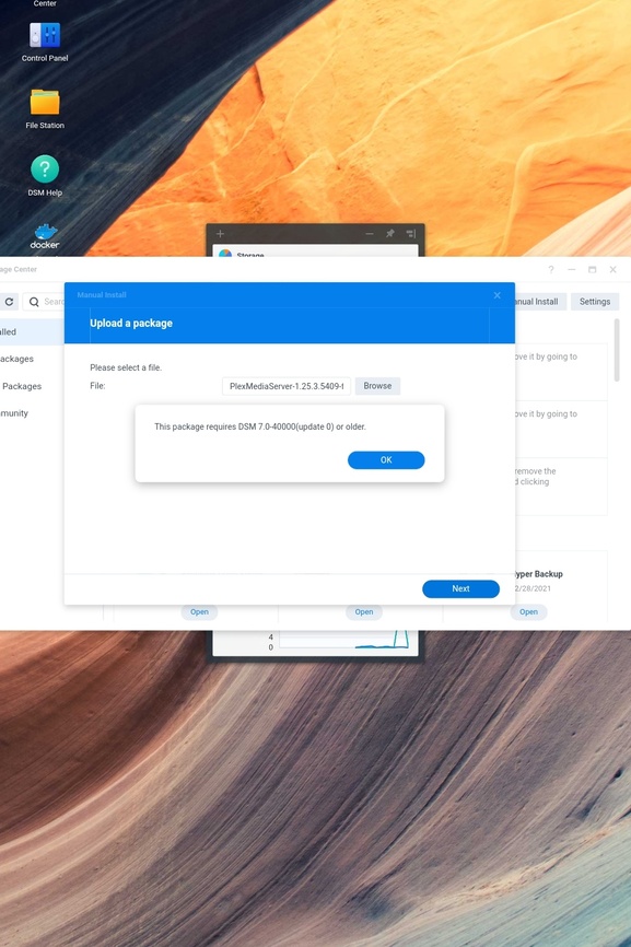

I tried that. Still doesn’t give me the option. See attached pic.
I even tried on several different devices.
I also tried to download the package from Plex and install it manually but it said that that package is not compatible with my version of DSM. I think it was looking for an older version.
@netspear
  1. which version of DSM do you use?
    – DSM 6 packages are listed as “Synology”
    – DSM 7 packages are listed as “Synology (DSM 7)”
Newest version of DSM 7
This is the error I get when I try to install it manually
Thank you.
You accidentally downloaded and tried to install the DSM 6 version.
Package Center is telling you that it wants the firmware to be older than DSM 7.0-40000 (the beta launch) in order to install — which is DSM 6.
Download the version for (DSM7) and you’ll be ok.

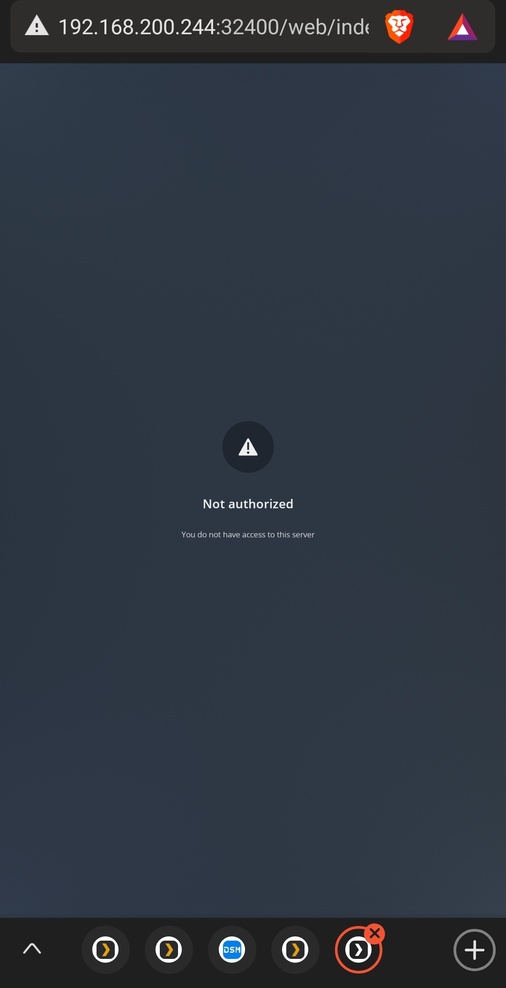

I tried the regular install and the version using the claim code. But I’m both of them it said not authorized when I tried to launch it.
@netspear
Are you opening Plex using the Synology’s LAN IP or are you attempting to use the QuickConnect.to URL?
The URL, if active, breaks claiming. It’s a bug in DSM I’ve not yet been able to work around (but have some ideas)
I just uninstalled it and reinstalled it using the claim code. And tried to login using the ip:32400
Gave me the same results
But when I installed it. It had a pop-up saying I claimed it. And it shows up in my authorized devices list.
