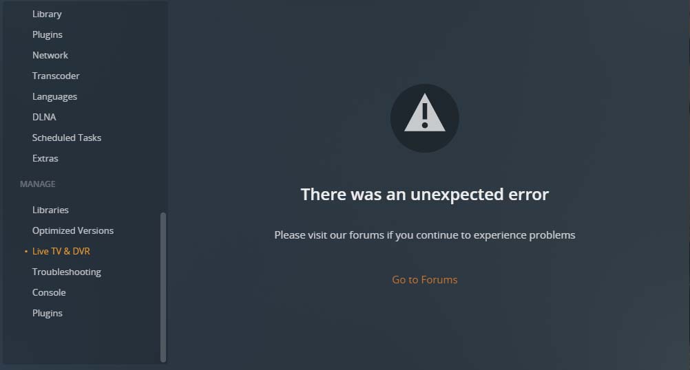

Tuner Make/Model: HD HDHomeRun CONNECT QUATRO & HDHomeRun FLEX 4K
I was trying to add a second HDHome Run Tuner and am now stuck with “There was an unexpected error - Please visit our forums if you continue to experience problems”
Plex is running in a docker container.
can you get your server logs
All or anything specific?
Those should fine for now. Which one are you trying to add?
I can’t add or edit anything, I just get the error when I click on the Live TV & DVR settings.
I get a quick flash of the settings before I just get the error screen, I cannot select or edit anything.
I have restarted the docker container, still no go.

Same version of Plex, also dockerized and same issue for me.
Added an xTeVe tuner just fine, but within a split second the guide had disappeared and the settings page of Live TV just throws an “unexpected error”
I’ve stopped xTeVe for now, so that hasn’t been running for a few days now.

I have looked at the logs and I am having difficulty matching the error screen you uploaded “There was an unexpected error” with the Plex Media Server log which was covering Nov 16, 2021 22:38 to 23:36
I can see successful requests to the server from Plex Web relating to the DVR with OTA Lineup “Local Broadcast Listings” - this was at 23:22:58 and cannot see any errors
This was for HDHomerun DVR on 192.168.10.22
Was the screenshot at 23:23 ? There are no errors in the server log at the time and also the requests from Plex Web all completed within few milliseconds - so not a slow response issue or timeout
