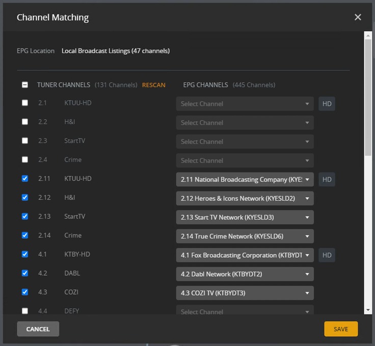

@janstadt show me what you’re channel mappings look like in your tuner setup.
example:
Thanks Tieberius - I’ve deleted the table media_provider_resources and both restarted plex media server and rebooted the entire server. Still the same error message.
