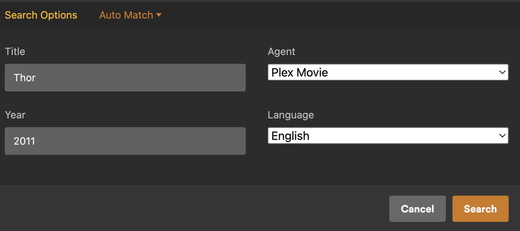

Thor (2011) is not matching.
I’m using the Plex Movie agent which has matched 7000 other movies without problem.
Screenshot below. I have already tried moving it out of the watched folder, scanning, emptying trash and then moving the file back but it still won’t match it automatically or manually.

Plex is able to see the file but is not able to match it despite the year and title being parsed correctly–
EDIT: it appears to be an error within the agent plugin as per the server log–

I was able to get it to match by changing the title to THOR (all caps). Very strange.
It is still in the depicted location as well.
