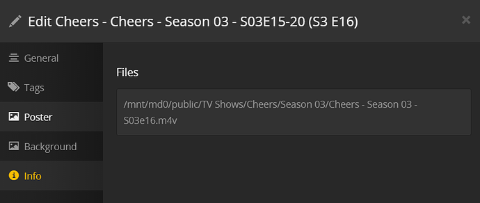

For some reason, even though I have followed the same naming convention for all of my tv shows… Plex won’t pull the episode name correctly. I’ve reordered the Agents as some suggested and refreshed all metadata… I’ve erased the episode name, ensured that it was not yellow “locked” and refreshed the metadata…all this does is change the name to the date of the episode.
I am using M4V files…which I now know isn’t recommended…oops… and I use the same process for every file: Rip to MKV (MakeMKV) and then compress with Handbrake. My naming convention is: Show - Season xx - SxxExx

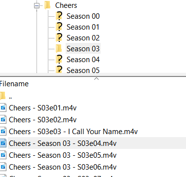

When I first rip a show, there are multiple files on each disk… so I will often use a naming convention that shows a range of episodes so that I can know which set is which..(see pic 2)..however, as soon as the MKVs are ripped, I change the file names to the correct one before I compress it to an M4V… so I’m not sure how it keeps picking up the weird old name. Additionally, if I look at the file itself in the details, it is named correctly.

/Cheers/Season 03/Cheers - Season 03 - s03e16.m4v is incorrect.

Your files are using the mp4 / m4v container, from which Plex is able to read the embedded Title meta tag.
Unless you do the above configuration change, Plex will prefer whatever is contained in this meta tag. (And, unfortunately, most of the time its contents are utter bollocks.)

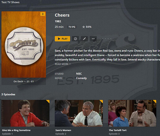

Using an existing .m4v file (not Cheers), removing all metadata via Windows Properties, and renaming per Plex documentation:
