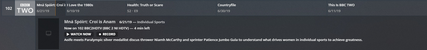

Channel 102 is mapping to “BBC 2 NI”. I can’t find a national flavour of BBC 2 to map instead
The programming for BBC 2 currently shows
Which all looks pretty Irish to me, and doesn’t match what’s currently being received!

Thank you for reporting, I can see that only BBC 2 NI HD is showing for 102 for the Freeview Anglia OTA Broadcast and also for the National. Will refer this to our provider

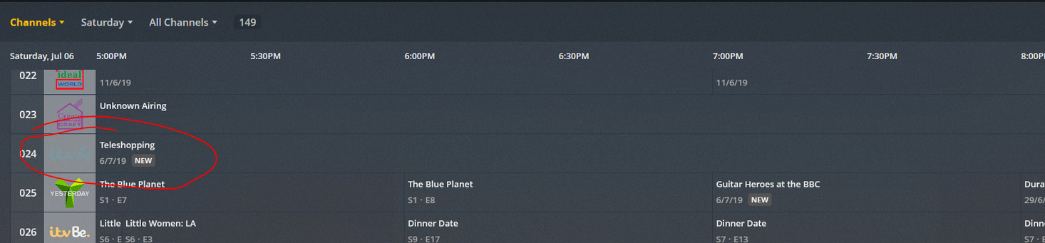

While we might not be getting “Network Programming…”, anymore some programming seems to be overriding what should be listed. For example in the image attached ITV4 has Teleshopping in the afternoon this Saturday. I know this is incorrect as Le Tour highlights are on this channel in the evening. For the moment I am having to use the repeat broadcasts in the middle of the night.
