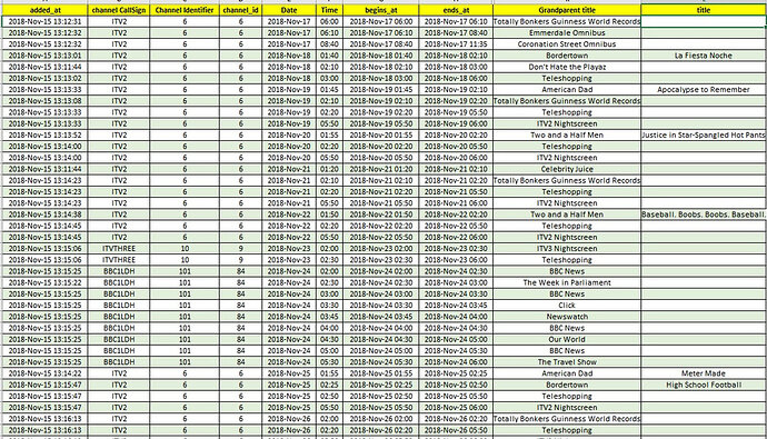

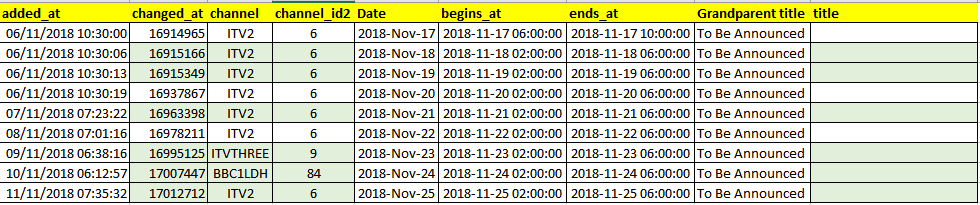

My last investigation into the news episodes that were all marked as To Be Announced showed that was the case for some episodes for period 17th November onwards and that it was the Guide Data that had it set as such and not Plex. My thought was that the guide data would get amended nearer the time
So the question now is where these that were showing have now been adjusted - snapshot here as it was 5 days ago
It is very possible that the details for some news items do not get filled in till closer the date. If all those in the above extract are still To Be Announced then will see if i can refer such issues to our metadata provider.

The database from Friday does show all these that were TBA’s got filled as we got closer to the dates
How they were on 12th November
and they did get filled -
and this was the position Friday 16th evening
So all TBAs for these replaced by actuals. I like to know if you ran a manual refresh on the 15th and at what time.
Friday evening db does show new future program TBAs - I need to establish if they would eventually correct themselves as we get closer to the date and if the default incremental updates make that correction. They should if the raw EPG data gets corrected
These are the TBAs at the moment (sorted by channel this time)
