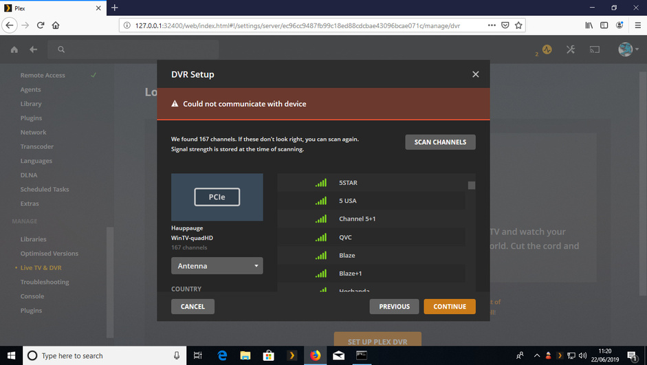

hi @sa2000
something seriously wrong wioth the scanner now, I cannt finish a mendip scann, it gets stuck at 95 % see screenshots.
also included logs into the zip file
Full amd Mendip.zip (5.7 MB)
@Sa2000
This build has some serious issues, I’d added a HD homerun but now it can’t find my WINTV PCIe Card. It’s like theres a switch in Plex which support either HDHomerun or WinTV CArds not both ? Any suggestions?
@systemshark That’s a strange one!! I’ve just tried adding my RTL based TV Tuner and it’s working alongside my WinTV DuoHD Tuners, in effect giving me an overkill 7 tuners, so the issue you’re having is one that I’ve not come across. I wonder if @sa2000 can help? Get those logs ready though :smile:
