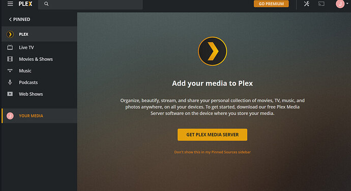

Under Plex Web—General (the menu on the left) I cannot create and control libraries anymore. Cannot force rescans of those libraries either… OS=windows10
Mind sharing some more details?
Where exactly are you trying to create a new library? Do existing libraries no longer offer any context menu ()?
I used to be able to customize my libraries in the left section of the interface. It was the only way to force rescan of new files.

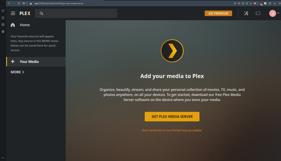

Now it prompts me to get a new server but its already running on Synology..I cannot create new libraries and bind them to NAS directories.
Still not sure under what circumstances you’re experiencing this issue.

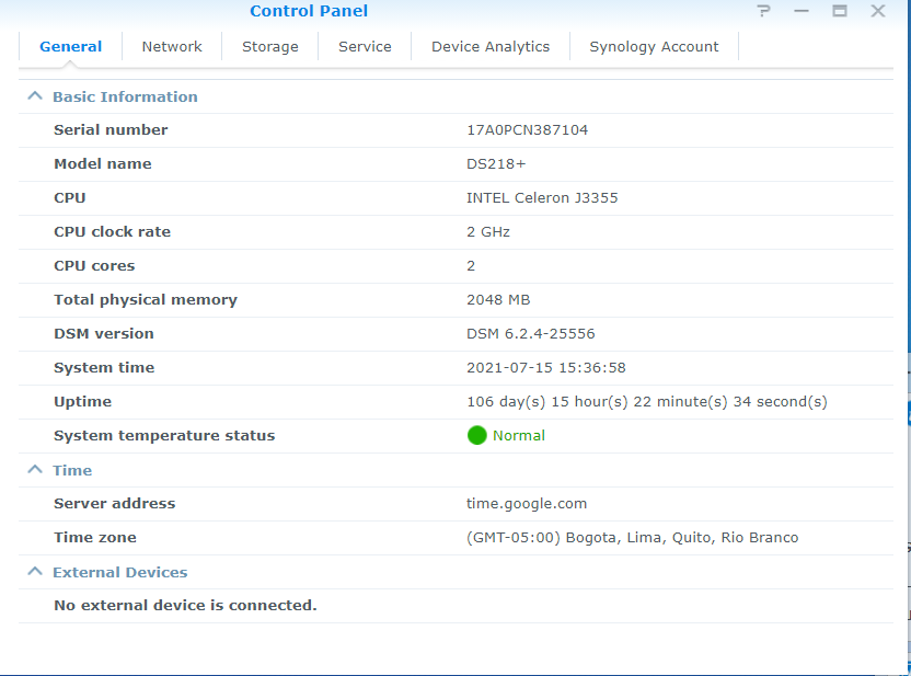

What version of Synology’s DSM do you have installed on your NAS? Is that still DSM 6?
DSM6, yessir
First… make sure you tested accessing your server through the bundled version of Plex Web – use the NAS’ local IP address (no host names, no quick connect address).
If that’s still not working you can try the following procedure:
The Plex Share described in this procedure is hidden by default. To see it, follow the 1st set of steps from this guide (“… to make it visible”):
After going through FAQs I stumbled across the fact that the server wasnt claimed. I’m trying to fix it now-updating metadata,

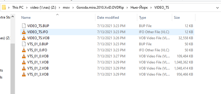

Changing subject: were you ever able to make Plex play DVD format videos, my Plex just doesnt see them
I tried different tutorials - none worked., just says No Content.
Plex ignores raw DVD / Blu-Ray backup folders or disk images.
https://support.plex.tv/articles/201426506-why-are-iso-video-ts-and-other-disk-image-formats-not-supported/
If you want to keep not only the main movie but also some of the extras, you can add all of those as local extras to your movie file.
https://support.plex.tv/articles/local-files-for-trailers-and-extras/

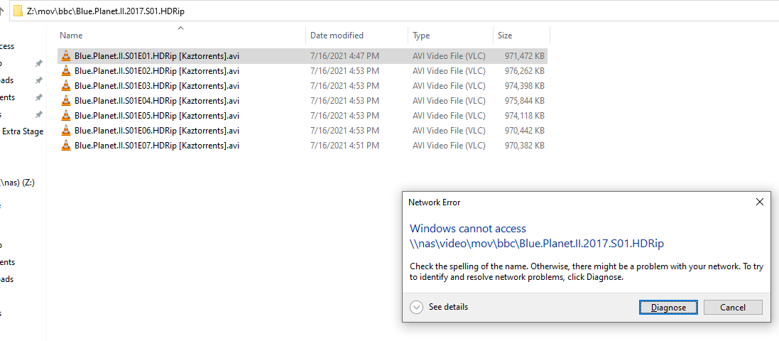

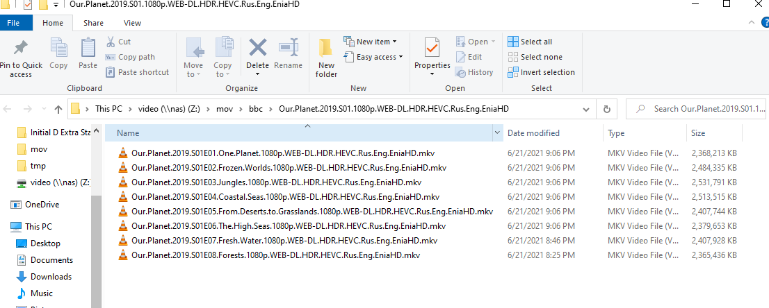

Would you happen to know why I’m getting “No Content” on some avi and mkv files?
What do you mean by “No Content”? Plex won’t find your files and shows the library as empty (“No Content”)?
If so… the most likely culprit is bad file naming.

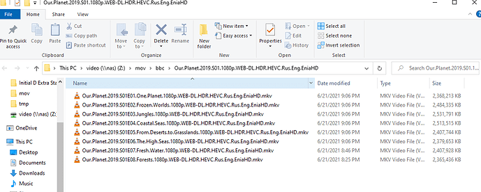

These 2 directories are giving me No Content when I navigate to them with my LGTV . Should I rename files using special naming convention?
I can play the files manually with Vlc but Plex gui cannot see it:
Also I cannot rename the files - something is locking them .
Torrent client is currently NOT running.
You need to stick with the naming schema – at the very least don’t mix tv-shows with movies. As per the support article about why Plex might ignore some files: Plex will ignore files named in accordance with a tv-show naming schema in movie libraries and it’ll ignore files missing that tv-show schema in tv-show libraries.
