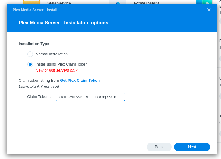

Please follow the steps I show above.
It claims the server as part of the installation process.
After following these instructions, the PMS is claimed by my account.

  1. Did you use this method when installing the PMS package ?
( You get the claim token by clicking the link, copying it, and pasting into the box )

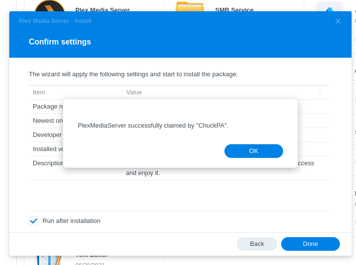

  1. When you install with this method, and it completes successfully, in the final popup, you’ll see this.
Did you get these results (your username) ?
Yes, i was able to claim with no issue. However the actual server is nowhere to be found whether on plex.tv or direct. It says it is claimed by me (via authorized devices), it is also the only server i have registered.

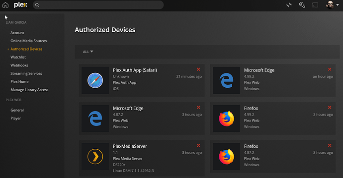

PMS - “Authorized Devices” does show the NAS registered under my account (Argentsamurai) same account im using to type this.
Attached is a picture of the account, with the NAS showing as registered, however it is not in my account. This is directly through the IP.
