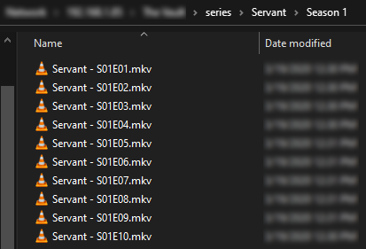

I’m unable to retrieve any metadata for the show Servant (2019) and Cosmos - Possible Worlds (2020).
I’ve tried adding release years to the naming conventions, no luck.
Removing and adding “-” for Cosmos, no luck.
cosmos servant
Any ideas?
