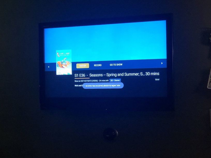

The most frequent error in the Preview app looks like this.

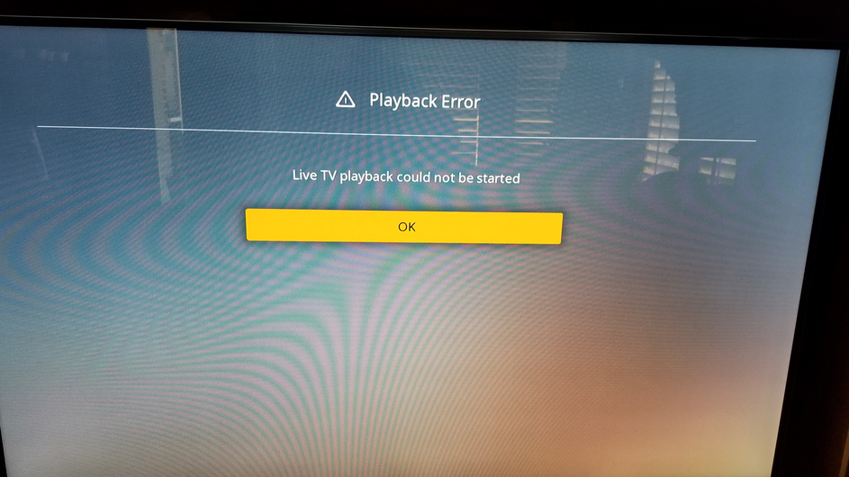

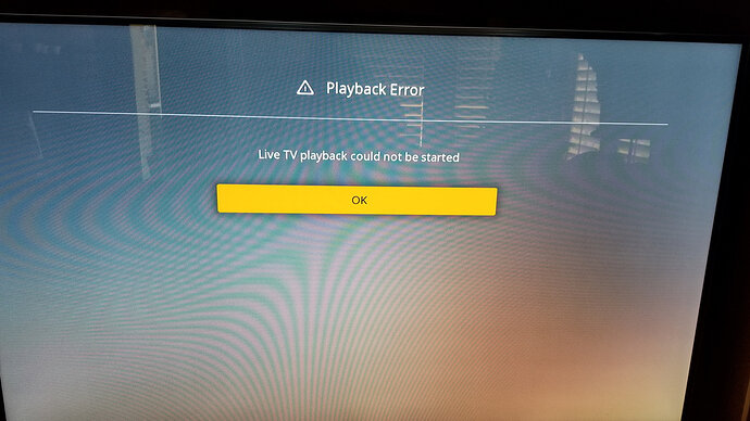

This is also a frequent occurrence when you do get a channel to tune.

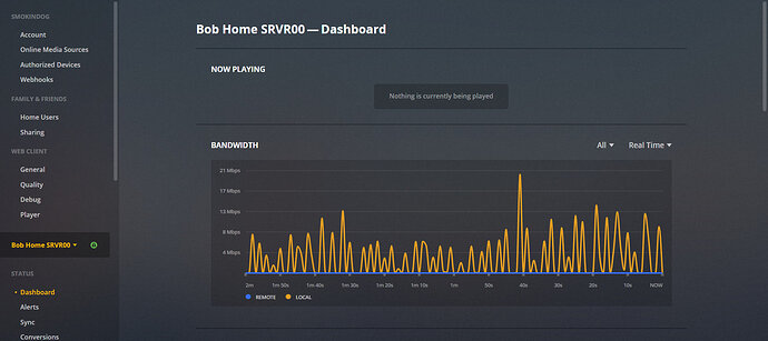

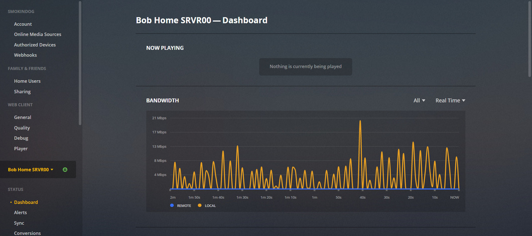

OR you can get tuned in and get this. YUP, watching a station on LiveTV via ROKU 4660 and Server thinks nothing being watched. Look at the bandwidth vs the “NOW PLAYING”.
