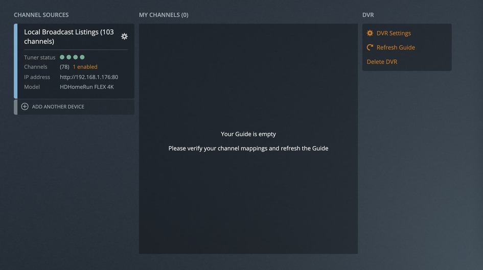

Oh my god, it’s back at it again! I deleted the DVR (after @AndyChips 's workaround), set my tuner back up again, and it was working for about a day. This morning, on my devices, it said “No guide is available” and I went back to the DVR settings and it had that same error message! I don’t get an error message when accessing it locally, but it has unmapped most of my channels for some reason (it has been doing this for a few months actually.

A couple days ago, around December 6, 2021, I pulled the latest image of the plex docker container, rebuilt my server and encountered the “Unexpected error” when going to Live TV & DVR Settings page; the screen flashed as though it worked for a second and then showed the error. Most of the advice on this post said to delete the DVR but I couldn’t.
But I did see that people could successfully delete the DVR with the docker image back in October which was about ver 1.24 (the latest version a couple of days ago was 1.25).
So I pull the 1.24.3.5033-757abe6b4 image and rebuilt my plex server using this image.
I could then successfully load the Live TV & DVR Settings page. I deleted my HDHomeRun tuner.
I then rebuild my Plex server using the latest 1.25.* image and successfully accessed the Live TV & DVR Settings page to re-add my HDHomeRun tuner. I see the guide and can watch local channels. So far so good.
