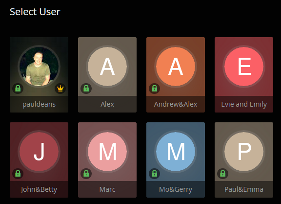

Does anyone know of a way to copy Playlists from one user to another?
For example I have made some really good playlists in the Paul & Emma Login and want to copy to Marc and Alex’s respective user login can this be done? Or is it just being able to backup your existing setup like above talks about?!
I’d like to see this feature too… have playlists with hundreds of videos and were created before Managed users was even a “thing” so now I’d like to export those playlists to their respective new managed user accounts…
I also would like to know how to export/import playlists to managed users- I have all my playlists in the admin account, but want all user accounts to have access to them. I really don’t want to recreate them. THANKS!
I would also like to be able to copy playlists between users.
+1 copy playlists between users (or between servers also).
Copy between users on a single server should be as easy as adding a “copy to user …” or “share with user …” option to playlist edit or playlist actions. The copy can either list users associated with the current server/plex friends, or it could allow freetext entry for better privacy between users.
