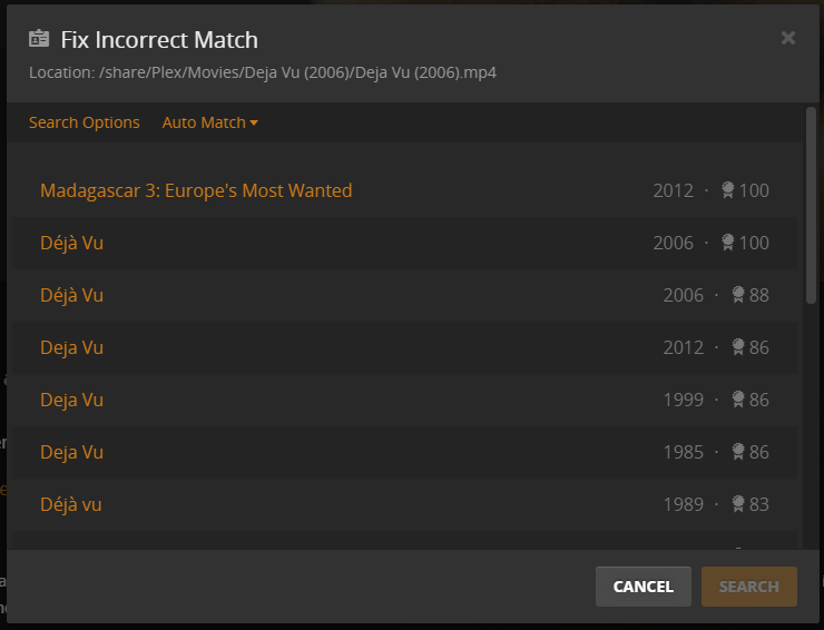

Why do all movies now match to Madagascar 3
I’ve been running a Plex setup for some years now and all of a sudden all my movies match to Madagascar 3. Its not a naming problem, as you can see in the attached
I’m running PlexMediaServer_1.3.3.3148-b38628e_x86_64 on a QNAP with firmware 4.3.2.
I’ve already tried using SQlite3 to export / re-import the database but its not made a difference. Help!

Hey thanks for the tip. You accurately describe my general practice when adding new content - transcode using handbrake into the folder that Plex is monitoring. I can also try turning off auto updating if you think that would help. But this used to work fine - its only recently got broken.
Note that the screenshot above is from a file added some months ago, and not from a partially converted Handbrake rip. As you can see the “Fix Incorrect Match” functionality is proposing Madagascar 3 as the top hit, so it seems to me that there’s something a bit broken somewhere.
