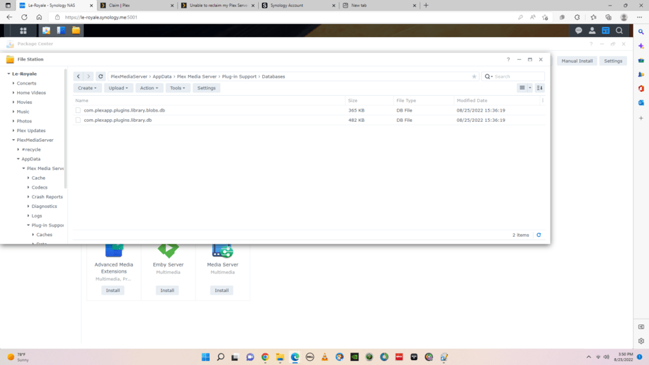

In File Station, navigate to /PlexMediaServer/AppData/Plex Media Server/Plug-in Support/Databases.
See the screenshot below from my DS918+.
com.plex.app.plugins.library.db is the main Plex database.
The ones with the dates on them are the backups made by Plex every three days.
Do you have any such backups on your server? If so, how far back do they go?
What is the size of com.plex.app.plugins.library.db on your system? How does it compare to the size of any of the backups, if they exist?
My DS918+:

Any chance you have a backup somewhere, taken before today?
I need to verify something with another person, but I think I know what happened.
I do not
