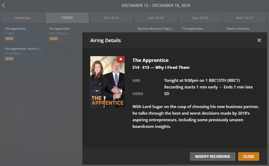

Recording -

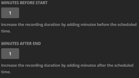

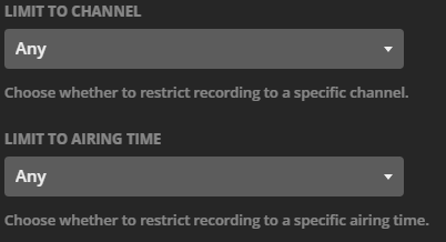

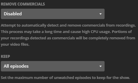

Advanced Settings -
Airing on Guide on HD Channel

Evidence is good - thank you. I can see the scheduled recording was recreated at 13:27 and that HD only was specified - and later one at 13:clock330:
Excellent, glad I got the right files. Yeah that was probably me trying to figure out why it was going to record in SD so tried saving the scheduled recording a few times haha.
It appears that the fix was tied into a new scheduler that has not been enabled - it is planned to be available in the next few days. I have now arranged for your account to have the new scheduler. I do not believe a restart of the server is necessary but may be it is best to do that. Please run with debug logging. Repeat what you did before, scheduling or amending schedule for existing HD Only recording and capture logs and db as before - before after making the change and if the problem is not resolved, logs during the recording
