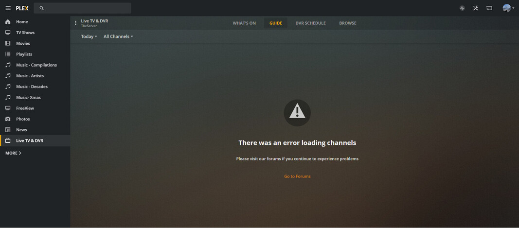

hi @sa2000 have done all the above recommended steps and still getting issues, issues loading the channels.
refreshing the guide did not address the issue, rebooting and refreshing the guide did not address the issue, however by adding a previously deselected channel the guide appeared again. This was done using the same xml file as what appear
Thanks for the feedback. I would need logs captured when it did not work and again when it did work to look into this
