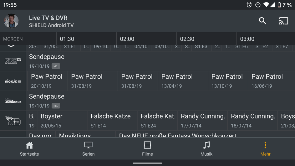

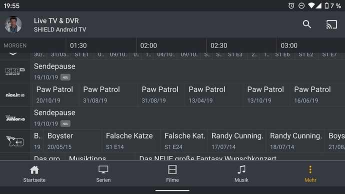

As an example 20.10. 01:15 to 03:05, but extends to a lot of other airings. See screenshot
Additionally, there are airings without any information, E.g. 19.10. 23:10 and 23:15 also on nickjr. They appear several times per day.

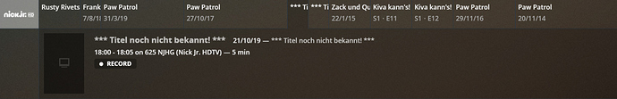

Just to add more fuel, this is from today’s (21.10.19) guide, from 17:15 (Paw Patrol 31/03/19) on 625 nickjr:
Enlarged is the airing of 18:00 without a title.

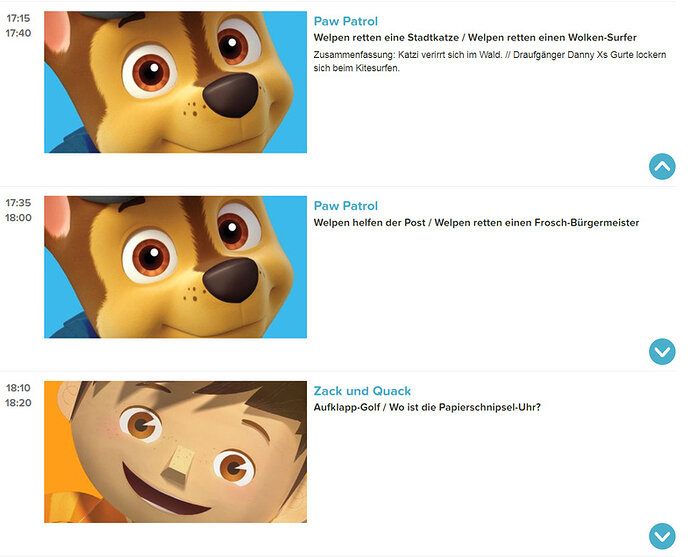

Nickjr does not give S/E information on their homepage, but at least shows the episode names. Funny enough, they also have a gap from 18:00-18:00 in their guide on their homepage:

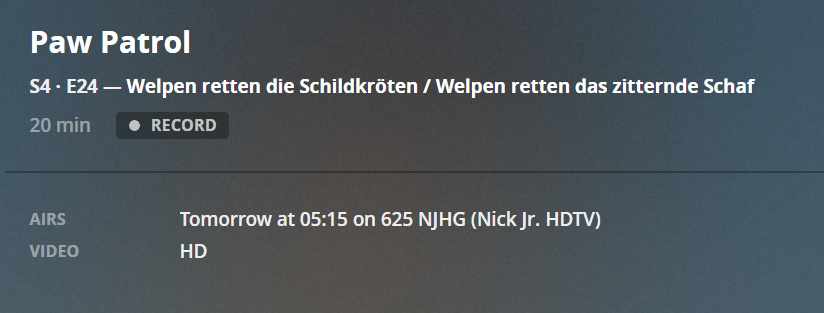

There are Paw Patrol airing with S/E information, so I guess your guide provider is generally able to get this from somewhere:
This is 22.10.19 05:15 UCT+2.
