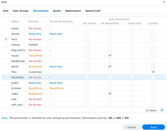

If the server is running on the Syno itself… can you verify the system account PlexMediaServer is granted permission to see the share / its content?
Morning. It is, KINDA:
“Plex”, not “PlexMediaServer”. So maybe this is a hangover from when I had DSM6, and now I have DSM7 it’s defunct? So per the link you shared, manually create a new used “PlexMediaServer”?
As you can see, Plex user exists and has access to the correct folders but does NOT have access to PlexMediaServer. If I give this existing user access to PMS…?
Or do I have to manually create a new user called PlexMediaServer?
Plex server doesn’t have the ability to create itself as a user no? I don’t remember having to do this manually before, but it would have been yeeeeeears ago so I probably wouldn’t remember either way.
Thanks again!
Also in Shared Folder I gave PMS the same permissions as Plex has:
But I note Plex is a user and PMS isn’t. Both are shared folders. So I probably DO need to create a user. Can I just change the username from plex to PlexMediaServer? Should it be upper or lower or camel case?
As you’re on DSM7, you got your permissions upside/down.
You still have granted permissions to your media to the plex user – that’s the user used on DSM5/6. With DSM7, you need to give the user PlexMediaServer permission to access your media.
Also… this is not about giving anybody access to the PlexMediaServer share. That’s just the place where Plex stores its database and supporting media – no place for your media or anything to touch manually.

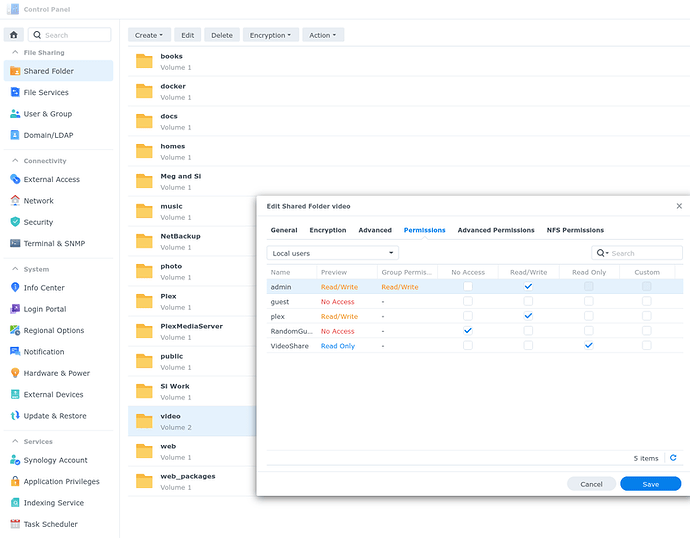

Hiya, probably I’m misunderstanding but I’m not sure those instructions are still valid for DSM7. Per my screenshot under “KINDA”,
shared folder > video > properties > permissions: there’s no user “PlexMediaServer”.
From the guide link you shared:
  1. If user “Plex”/“PlexMediaServer” isn’t listed, we will need to add it to the list of username (top box)
But there’s no obvious way to do that in DSM7 within that open dialog box. But “top box” is ambiguous so:
Top box = buttons in Shared Folder: no option to create user.
Top box = taskbar: can see admin account details on the right, or go into general menu.
So I think “top box” may have changed in DSM7?

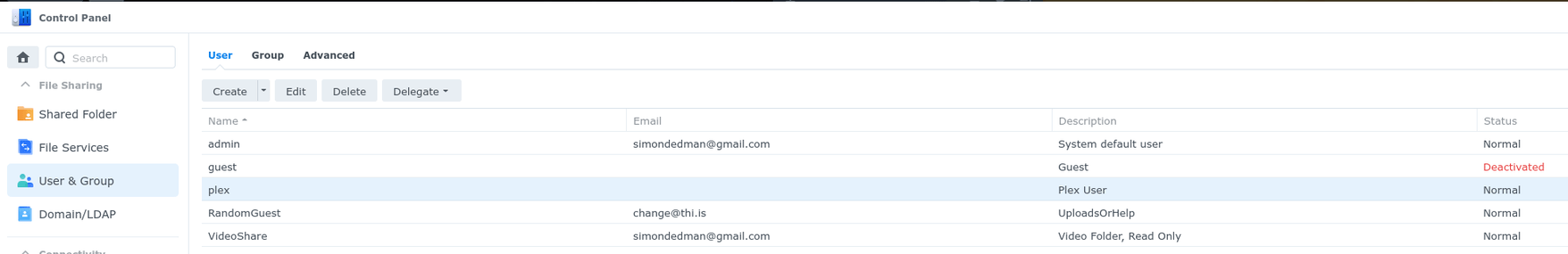

My suspicion is that I have to add the user PlexMediaServer in Control panel > user & group > create user, OR edit the existing “plex” user since that is no longer valid?
Will simply changing the username from “plex” to “PlexMediaServer” allow PMS to connect to the NAS, e.g. if it’s connecting to the NAS as a user already named “PlexMediaServer”?
Hmm. Tried to simply change the name from “plex” to “PlexMediaServer”:
But PlexMediaServer isn’t a listed normal user…

On DSM 7, Synology does things differently.
  1. There is no user Plex anymore. It is abandoned. You can delete it.
  2. When you grant permissions,
    – “PlexMediaServer” is a “System Internal user” (it’s the application’s name)
    – You either change the “Local Users” (in the left corner) to “System Internal Users” and select “Plex Media Server”
    or
    – You create a new Read-only or Read/write permission rule
    – Check the box “Apply to this folder, sub-folders and files”
    – Click “Save”

  1. Control panel > User & Group > Plex user deleted.
  2. Control panel > Shared Folders > video > properties > permissions > System internal users > PlexMediaServer: read/write. Save.
  3. Plex: rescan library: success.
