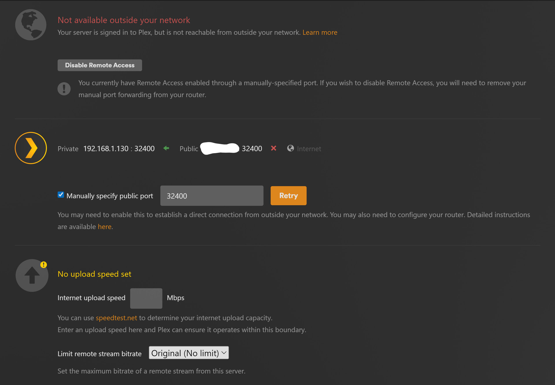

I am setting up my server for the first time, I have paid for remote streaming. But I cannot get the server to stream. I have read the help articles but I do not understand how to port forward. I have att internet. And the server is allowed through the windows firewall.
Server Version#:v.1.42.2.10156-f737b826c

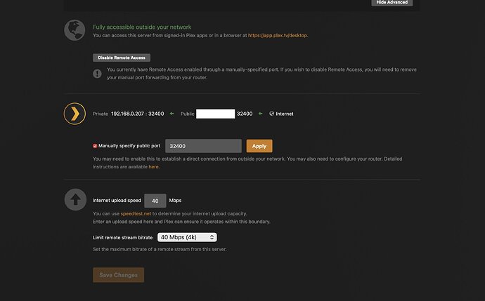

You will have to login to your Router.
Then Go to WAN services.
To set up Table it will look something like .
Screenshot 2025-12-03 at 11.59.25 am
Screenshot 2025-12-03 at 11.57.32 am

Thank you. My settings now resemble yours. I tried retrying the connection with the manual port forwarding and it was available for a couple seconds until it went back to saying it is no longer available.
So can you show me what happening here
