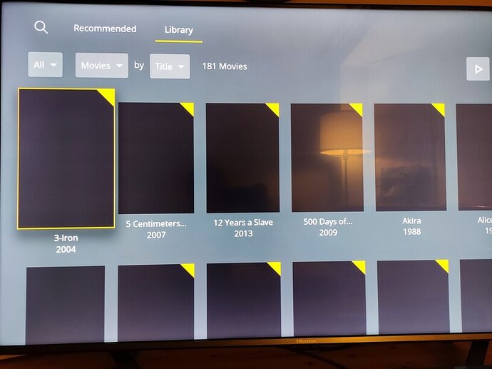

I am running Plex Media Server on a Windows PC and using the Plex app on my Hisense Smart TV (VIDAA U4), specifically model 50A7500FTUK. Although I can play movies just fine, for some reason the artwork/posters are missing when viewed from my Smart TV - see attached photos.
I assume there must be a fault with the client, as I can see the artwork correctly when connected using my Android phone. Is there any workaround for this, or is a fix needed for the app?

I enabled the setting to send logs to the server, then opened up a movie like in my second screenshot above and then closed the app. I’ve attached the logs downloaded from the Troubleshooting section of the server settings, hopefully that’s what you were after.
