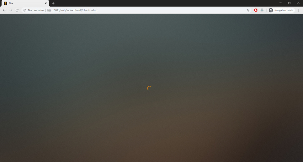

Nevertheless, even after following strictly the steps mentionned in it several times, when I connect to “http://server_IP_address:32400/web/”, it always redirects me to “http://server_IP_address:32400/web/index.html#!/client-setup” and it doesn’t load anything:
Any idea?

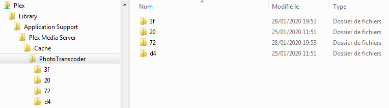

Also note that, in my case, the “PhotoTranscoder” foilder is the unique folder of the “Cache” folder you gave the path to. Don’t know if it has any impact on my issue and will focus on the double NAT issue.
