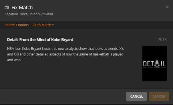

When trying to process Metadata for the TV Show “Detail” : Detail - TheTVDB.com, 415087 , my search results are always for Detail: From the Mind of Kobe Bryant: Detail: From the Mind of Kobe Bryant - TheTVDB.com .

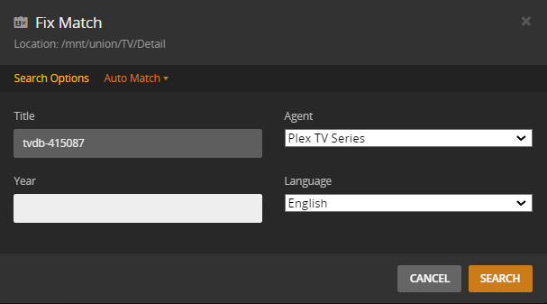

Even if I search manually for the TVDB ID:
The result looks like this:
I understand that TVDB is making things a little tricky because they have “duplicate” metadata, in that one series (Detail) is also split up into several smaller series (Detail: From the Mind of …), as well as being consolidated into the proper series (Detail). But would it be possible to get the Plex Database to properly parse Detail (the aggregated and “correct” way of handling this series)?

Makes sense! Then it will need to be added to TheMovieDB as just Detail, right? Is there a way to get Detail properly matched now (with just TVDB abilities)? I still can’t seem to find Detail (2018), Detail, or Detail [tvdb-415087] using the Agent (which is probably more a function of me not understanding how it’s supposed to work, than it actually not working…
I renamed the folder to have the TVDB ID and tried doing the Plex Dance and things somehow got even messier. Now it only matches “Detail: From the Mind of Peyton Manning” . TVDB API does seem to return all the proper information for the TV show Detail so I’m even more confused than I was before.
