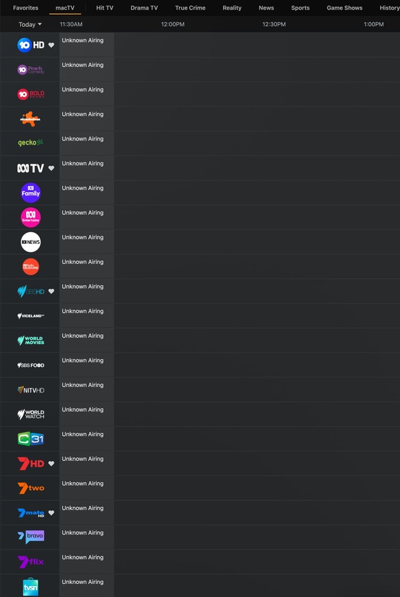

@BlairCadden I’m having exactly the same issue, this is a fairly major issue, no TV is a bad thing for my family acceptance factor.
Have tried re-adding the DVR, no change.
ERROR - EPG: received HTTP response of 502 from request to https://epg.provider.plex.tv/grid/bulk?channelGridKey=5fc70607052f6f002ef46651&endDate=2024-08-20&startDate=2024-08-14&X-Plex-Language=en&X-Plex-Token=xxxxxxxxxxxxxxxxxxxx
502 is a Bad Gateway error - “The HyperText Transfer Protocol (HTTP) 502 Bad Gateway server error response code indicates that the server, while acting as a gateway or proxy, received an invalid response from the upstream server”
I ended up switching to Xmltv for now just to get back up and running. If it breaks then I’ll switch back to the Plex guide. https://www.xmltv.net
I tried that, choosing a post code in a totally different city (Sydney instead of Melbourne), same 502 error in logs. It’s something on the Plex backend from what I can see.

The 502 errors are being looked into.
