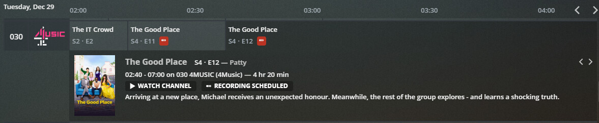

So far I’ve only noticed it on 4 Music (Channel 030) on Freeview but there seems to be an overlapping episode and unnecessarily long episode issue with The Good Place:
As can be seen Plex is showing airing for:
29/12: 02:10 to 02:35 - S04 E11
29/12: 02:15 to 02:40 - S04 E11
29/12: 02:35 to 07:00 - S04 E12
Looking at the Freeview guide the airings should be:
29/12: 02:40 to 03:05 - S04 E12
If I restart Plex for Windows and Plex Server, like I did last week, then the overlapping episode disappears but I am still left with the really long showing of S04 E12 on the 29th and S04 E13 on the 30th - both until 07:00 whereas most of that is Teleshopping:

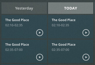

This seems to have also affected data for the 27/12 (yesterday) and 28/12 (this morning) but unfortunately I didn’t notice it until one of my fellow Plexers pointed it out to me:
The Good Place - DVR Schedule 201228
As I mentioned above, I also saw this last week. These are the screenshot from the 22nd and 23rd showing the same issues:
They show the overlapping episode issues as well as the long episodes. However, a restart seem to fix both problems. Unfortunately, this week only the overlapping issue is solved by a restart.

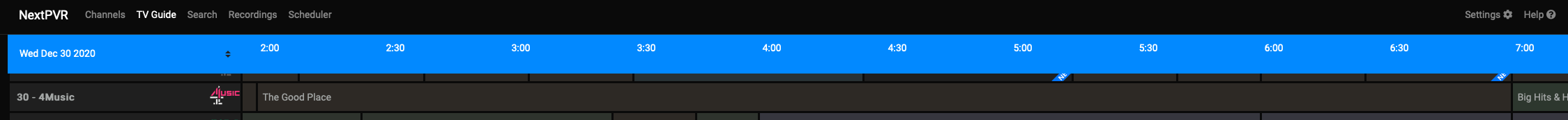

I have also just checked NextPVR (also w/Gracenote) and that displays the same problem, so this is not unique to how Plex ingests the data.

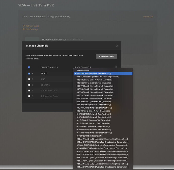

Hi Fellow Aussie, I have attached a reference to different transmitter locations. Now if it like my location there are different transmitter locations and duplication of a said Television network with or without regional influences.
Following the callsigns may help eliminate channels not required. Your Terrestrial Aerial direction and favoured HD and SD signals should be easier. It’s Unfortunate some postcodes, there will be duplication.
The drop down menu will assist further as in my screenshot.-
