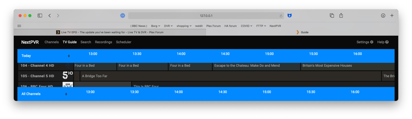

If you look in NextPVR’s EPG, they’re showing as single file recordings (no gaps). Let us know how you get on!

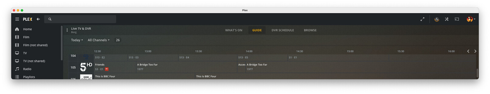

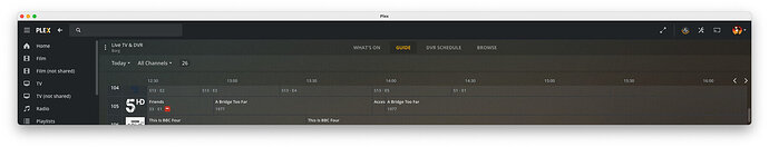

A bridge too Far (NextPVR)…
A bridge too Far (Plex)…
I can tell you now that it will only record the first hour. Plex confirmed they were aware of the issue / scenario and are looking into it. I haven’t seen any acknowledgement yet that they had fixed it!

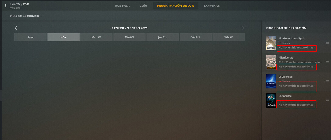

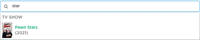

Are scheduling working for any of you, guys? It seems is not working on my side
On the first screenshot, I’m showing the shows I’ve scheduled and it says there is no new airings, but on the other screenshots shows there are plenty of them, last ones shows a show being aired right now, but DVR isn’t recording at all.
Manual recording works by the way
Did you delete and recreate the recordings as mentioned in item 3 in the first post on this thread?
Gotcha, then there’s a bug in the scheduling as I’m having a similar problem as @malevolent.

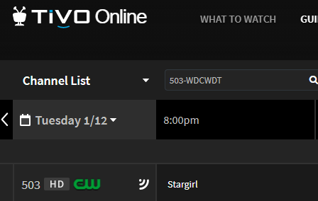

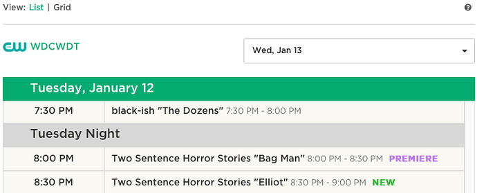

@johnm_ColaSC, I deleted and recreated recordings, but I seem to be getting a mismatch for at least one channel. CW in the US, zip code 20171. Gracenote says that Two Sentence Horror Stories is airing at 8 PM on 1/13, but TiVo says Stargirl is airing at that time. How do I get this fixed? Screen shots below.
GraceNote
TiVo
Which series are you attempting to record? Gracenote agrees with WDCW’s listing.
WDCW’s listings don’t have any upcoming airings for Stargirl:
