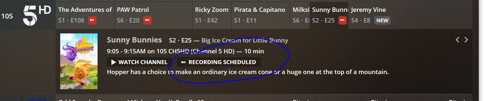

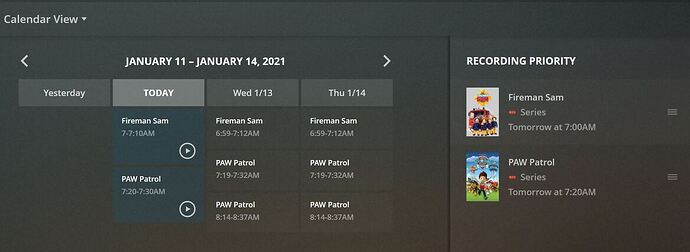

Here’s an example. I was able to add in Fireman Sam and Paw Patrol, but when I try to add in The Adventures of Paddington and Sunny Bunnies it shows in the EPG as already having a scheduled recording (pic 2) but not in the scheduled recordings list (pic1), and when I try to change the scheduled recording I get message in pic4.
I find that all episodes of a show being recorded display as such in the EPG (your 2nd picture), but ones that have already been recorded don’t show in the DVR (your Pic 1).
Can you check whether you already have a that particular SxxExx in the library you are recording to?
Ah, thanks. I’ve removed all the recordings and their folders from the Plex recordings location, deleted the DVR again and added it back and now I can re-set them up. Phew! Thanks
