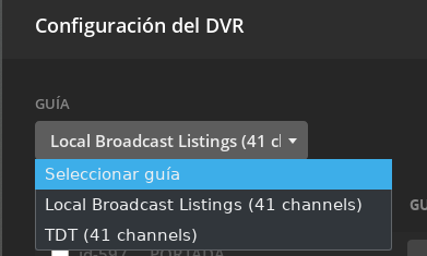

After a few days without using plex LiveTV at all, I tried again… now EPG is still even worse than two weeks ago. Now just shows broadcasts open channels, no PPV like movistar or other paid subscription channel guides…
What’s going on here?
Select “Local Broadcast Listings (41 channels)”
Dammit… I’ve updated my Server and I’ve don’t see the note
So i’ve lost my EGP and have to wait for my new EPG data, correct?
