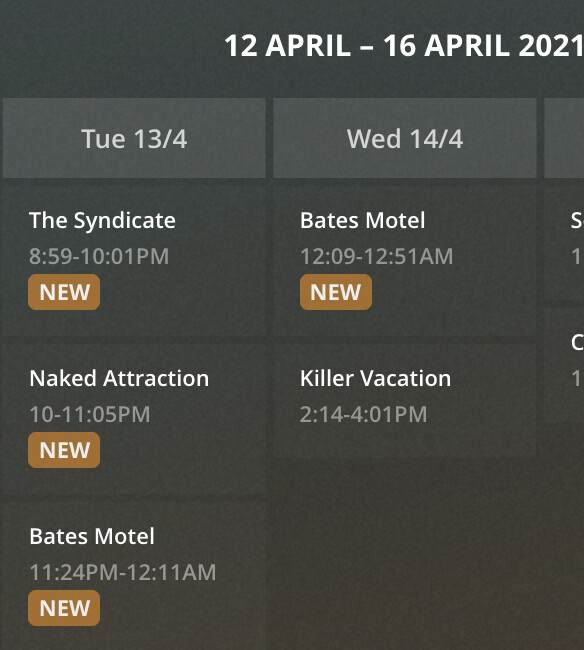

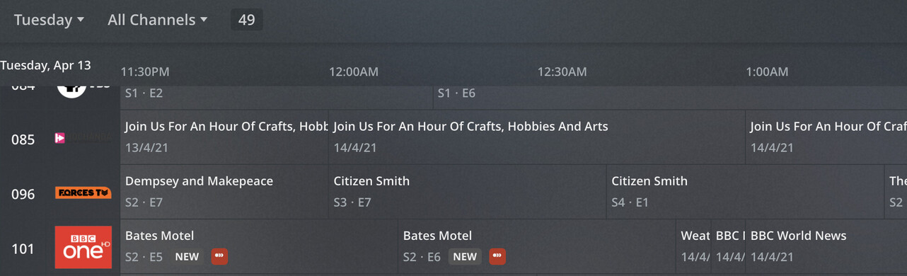

Bates Motel BBC1 HD and BBC 1
2 Episodes back to back
Show on Tuesday night and Wednesday morning every week
Plex only recorded Episode 1 first week and Episode 3 the next week
Failed to record Episode 2 which followed Episode 1
Same problem next week with Episode 4 not recorded
(I have channels running on a different tuner it recorded all 4 correctly so thankfully I have not missed episodes 2,4)
Guide has both episodes as due to record in EPG but fails to record the 2nd, 4th and presumably the 6th which is on next week
Could you get me server logs covering the time when the recordings were supposed to be happening - with debug logging enabled beforehand
