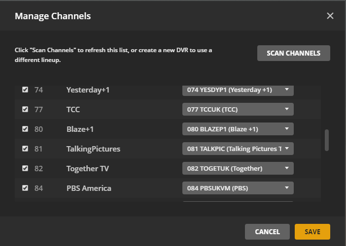

I don’t know if anyone else has noticed but it looks like Blaze +1 is now correctly identified as being an SD channel in the guide:
With the HD tag being removed from the channel scan ![]()
