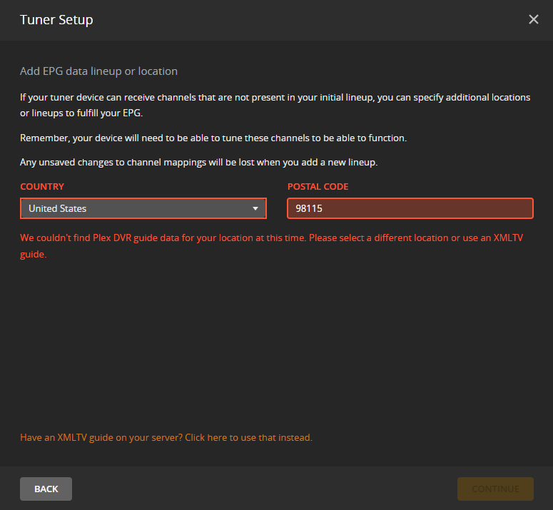

I am unable to load EPG data at all for my location (or any other I try). Totally unsure where to go to fix this

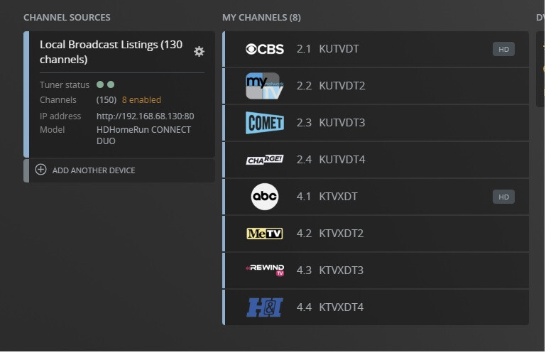

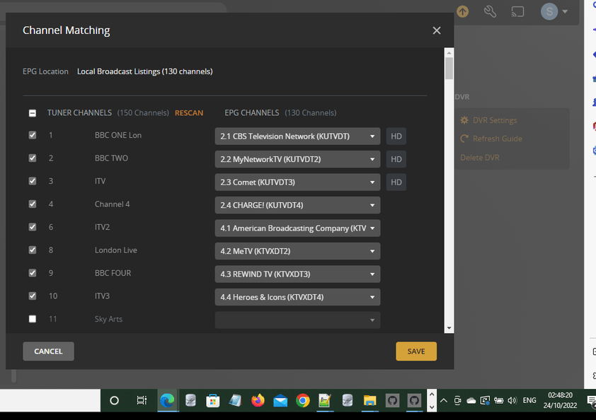

Yes this is what I was referring to. And when you select the drop-down on the right hand side, for 2.1 for example, you will see there are 3 different 2.1 entries in the lineup. But the mappings in your screenshot do show that you have selected the correct channels from the EPG with the KUTV set for 2.x and KKTVX set for 4.x

I tried to reproduce it running a PC with your timezone and time and setting up a DVR for your zip code and selecting the KUTV 2.x channels and KTVX 4.x channels and it was ok - no gaps / no unknown airings

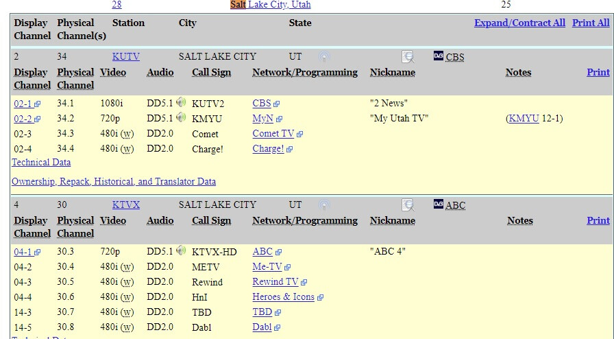

rabbitears.info shows these channels for your Salt lake City market
In my test I had these channels mapped
giving me these channels
and the guide showed up ok

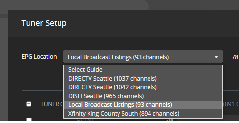

May be a network issue. I am able to see 5 lineups available for your 98115 USA zip code
If problem persists, please ensure you have debug logged enabled on the server - see https://support.plex.tv/articles/201643703-reporting-issues-with-plex-media-server/
and then restart the server to get fresh log files created and go through DVR setup and when you get this error note down the time and take a screenshot and then download the server logs and attach with the screenshot and time

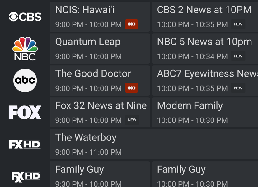

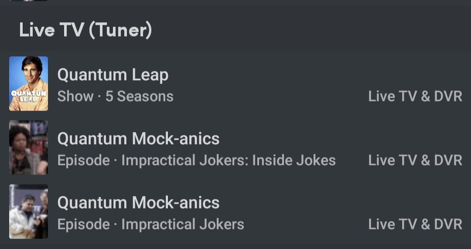

Here’s what I have (see screenshot). The description seems right for the new series, but the overall series is wrong and it doesn’t see the episode as “new” so I have to fix that by recording everything and not just new episodes. Then it picks up reruns of the old shows so I have to try to scope Maybe this is just cached bad data that will eventually go away.
Also, when I go to search for the show on my server I get one series that’s 5 seasons instead of two, one with 5 seasons and one in the first season that’s 6 episodes in like it should be
The zip code is 60156 and the provider is Comcast - Carpentersville. NBC HD there is channel 188. It airs at 9pm CST.

I see three Monday 9pm CST airings in the schedule and they are for the 2022 Quantum Leap Series and all 3 have the New indicator
Can you refresh the guide and check the guide screen

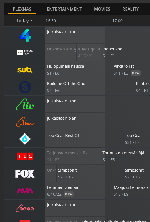

There has not been any information for four channels in two years. i thought maybe ill finally ask if you guys can get working EPG to finland too. so “julkaistaan pian” means roughly publishing soon. that has been there for couple of years and no matter what plex server version i use, no matter what postal code i give, no matter the listing, there just is no EPG information for these channels.

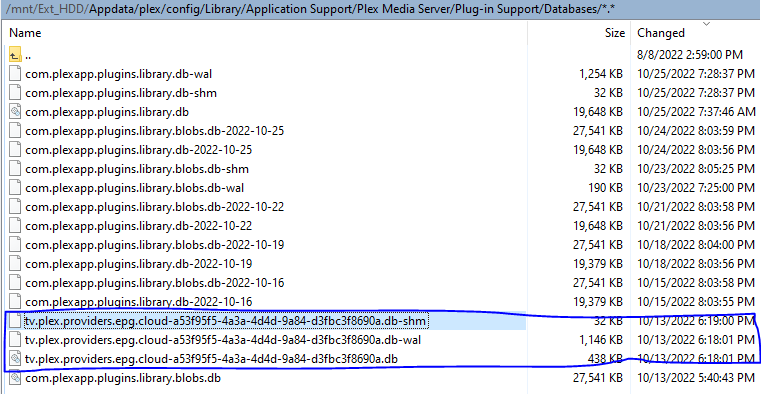

So I did a refresh of the EPG data and was able to locate the files you referenced regarding log files while doing the update. However, the EPG data files (the ones stored in /Plug-in Support/Databases/ that start with tv.plex.providers.epg.cloud) were there while the refresh was ongoing, but when the refresh completed, they were no longer there. I did this twice and had the same results. These EPG files populate while the refresh is initiated and ongoing, but are gone upon completion of the refresh.
I did observe some older EPG data files that were last updated back on Oct 13 (not Oct 25 like the ones I was hoping to ascertain). I’ve included those older EPG data files in case they may be of use because those EPG data files were changed/created during the time I’ve had issues with my Live TV/DVR guide. But perhaps maybe the issue I’m observing with the guide data is related to whatever is removing these EPG log files.
Below is the requested log file for the PMS and a zip file of the EPG files (3 total files within, but are from Oct 13, not Oct 25 due to unknown issues of the files being removed after a refresh).
2022-10-25.zip (151.7 KB)
Plex Media Server.log (340.1 KB)
If I missed anything or if I need to provide additional clarification, please let me know. Thanks.

I am sorry but Gracenote have indicated that they do not have data for a lot of the Finland channels
I will ask them again if there is any imminent change
