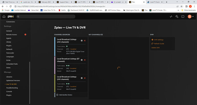

On the DVR Settings page, click on the 42 enabled channels link and a run a channel RESCAN
At the end of the channel scan - see if 39.1 appears on the left side and gets matched
If it does not, get the lineup list from the DVR
I expect it to be by sending this request
http://192.168.62.4:80/lineup.json
Copy the response into a text file and attach together with the zipped server logs

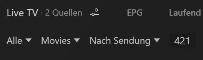

i have some questions for the EPG “Browse” filter:
I think “(Nach) Sendung” is a bad german translation, “(Nach) Ausstrahlung” or sounds better for me. Can’t remember what it was before but it changed a few weeks ago…
second, a filter for language or HD channels would be nice.
also there is a bug, i you switch the second tab from Movies to Show or anything else, the first tab is resettet to all.

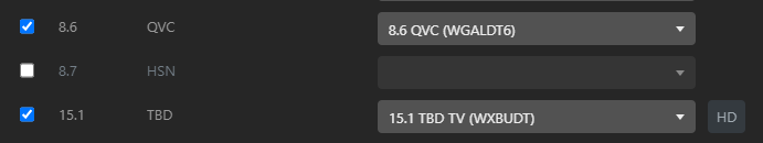

- A broadcast channel is missing from the EPG and cannot be enabled.
- Lineup Name: “Local Broadcast Listings (80 channels)”
- Channel 8.7 - HSN
This has been referred to Gracenote
