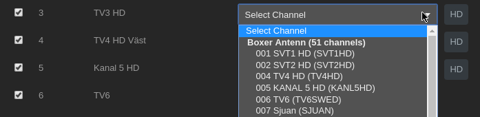

Now TV6 is working but TV3 has disappeared.
- A Boxer channel is missing from the EPG.
- Lineup Name: “Boxer Antenn (51 channels)”
- Channel; TV3
- Sweden
- Postal Code: 47193
- PMS 1.31.1.6782
May be there was a network or cloudflare issue at the time - I just tried zip code 78613 and got lineup Local Broadcast Listings (243 channels) returned for selection.
