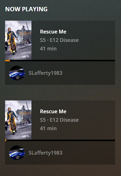

  3. All apps I have tried when starting playback of anything from the DVR, it starts 2 streams for the same content. One is direct play and the other is transcoding. I will update with a screenshot when I can replicate it, but it appears now this is occurring randomly as well.

I hate to hijack a topic, however I have also been experiencing the duplicate stream problem. I created a topic 4 days ago, and so far no Plex bods (Moderators or Employees) have yet to take up the reins on this, which I find more than a little frustrating!

A user on my topic rolled back as far as 1.16.5 and still has sthe duplicate stream problem! Get that !!!
What I wanna know is, why are all the Plex bods ignoring this? @darcilicious… Any ideas?

I’ve just updated a separate instance of PMS on a different machine to 1.18.1.1973 and can confirm that the duplicate problem is still apparent.

Hi all.
Just wanted to let ya’ll know that BigWheel started looking into the Duplicate stream problem yesterday…
