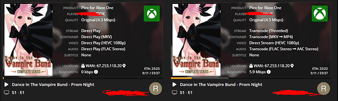

Just as I was typing I’ve seen two entries for the same tv show pop up from my friends sole XBOX one, I’ve managed to grab a screen shot.
Is there some bug in the Plex XBOX client which is causing multiple transcoders to run simultaneously on my server, perhaps triggered when streaming quality is changed?
From the picture I can see both are running at different resolutions, so it appears my mate is dropping the bitrate down I guess, unless happening automatically. However my server is fixed at 720P for remote streams, so no idea how the 1080p stream should have even started to play.

Yeh, I have noticed this behavior for my other friends XBOX as well… One of the offending streams is always a 0bps stream, and kills itself after 5 minutes or so… I haven’t checked through task manager yet, but the 0bps stream is always a DirectPlay stream, and the other stream is always a transcode stream… So it’s not transcoding multiple times in my instance… and from the screenshot above, it doesn’t look like it’s doing it in yours either… Though I typically Monitor with Tautulli cause it gives more information
