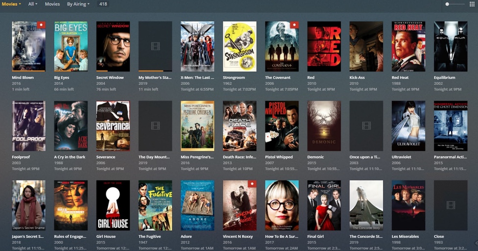

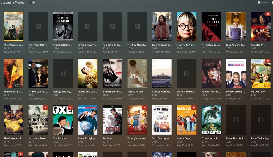

This appears to be an issue with what plex has chosen to display and how
In the new Mac,Windows and iOS app Plex shows movies at random and not in date/time order
My list starts with a movie for today then 1 for tomorrow then Wednesday - Scroll down a few movies todays movies show up
In the web interface via the browser these all show correctly in airing order
So I guess the issue is how Plex in the app is choosing to display the movie list - I cannot see a way of setting things like the web interface has IE By airing/Release date/Name
UK Freeview. HD Homerun tuners
