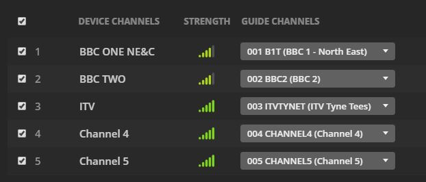

Is the mapping of channels in setup showing correctly like in this screenshot?

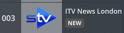

This got me look - and on STV, I have ‘ITV News London’ (Freeview STV Central OTA Broadcast) - screen grabs attached.
33 53
I have just setup an EH1 post code DVR and I can see that whilst the channel correctly identifies itself as the stv, the guide data is for London.
I am referring this to our provider

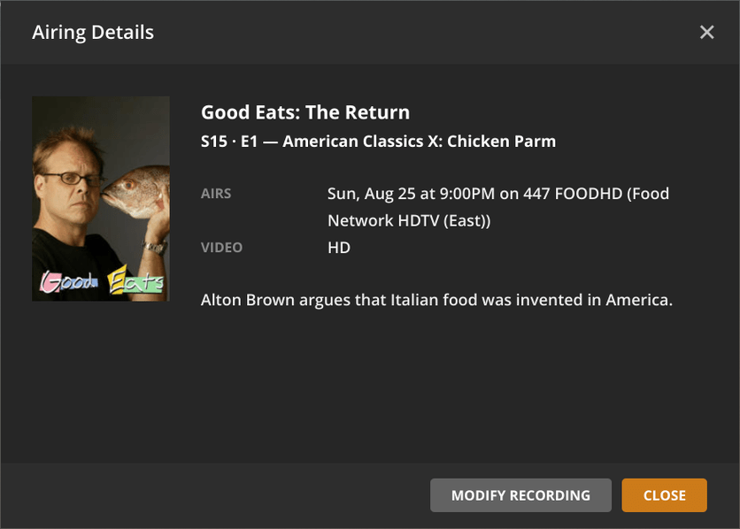

Season information has been fixed – yay! However, we can just call this one “Good Eats” and not “Good Eats: The Return.” It seems like this is being treated as a continuation of the original series. Having it named “Good Eats: The Return” is going to mess with the first 14 seasons. Best to just name it “Good Eats.”
Anyway, glad to know these things are getting fixed so quickly.

Is this correct for BBC?
Freeview Tyne Tees OTA Lineup
Whether it is the way it will stay going forwards I do not know, but I can confirm that I see the same as @paulsalter, albeit for a different lineup (Freeview South West OTA). That is to say, regionalised news on ITV and generic Local News on the BBC.

Thanks for the confirmation. This is in line with the feedback I had from our provider. They will look into if it is possible to get specific titles for the BBC regions

This was looked into and the decision was that it should be left as it is. The Press Release for the show calls it “Good Eats: The Return” and the graphic for the show also said that.
Fair enough. Once it’s added to my library, it’s being handled correctly, so I’m happy. Thanks again for being so quick on some of these corrections.
