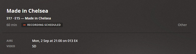

There is a new series of Made in Chelsea starting on E4 in the UK on Monday night at 21:00. The episode is flagged as being new but rather than being S18-E1 which is correct, the episode is currently shown as S17-E15.
Screenshot iand comments based on a Freeview South West OTA guide.

I will refer the incorrect episode number issue to our provider

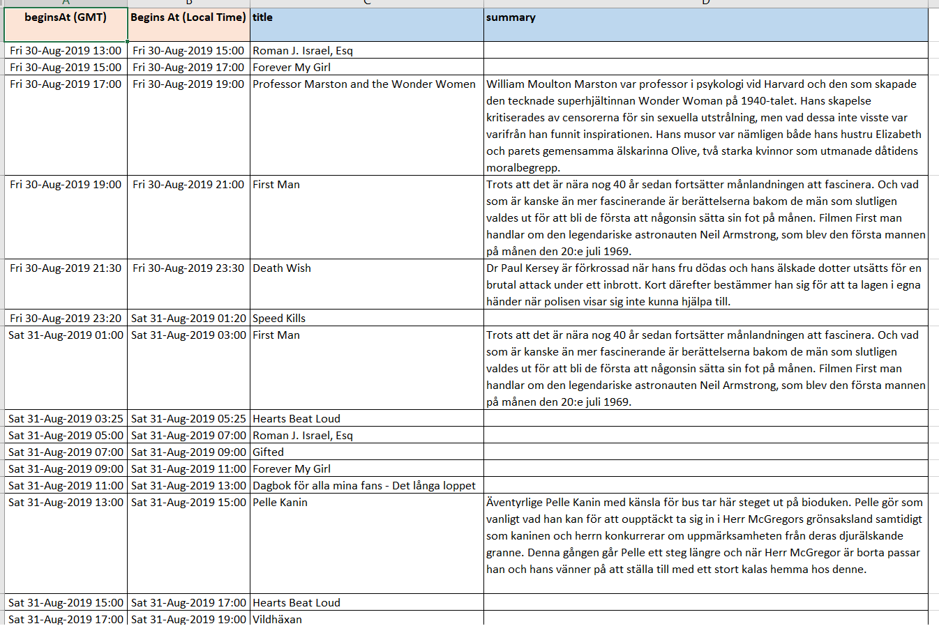

Channel 97 “Viasat Film Premiere HD”
The issue being that it is showing data for the Norwegian channel instead of the Swedish channel.
Are you able to point to specific airings for today and in following days where this is happening, The first ones I checked are the same airings in both the Swedish and Norwegian channels
I have extracted first few films from the EPG . According to Google Translate the text in the summary is Swedish.
TV Schedule - Viasat Film Premiere Sweden (https://www.viasat.se/tv-guide)
TV Schedule - Viasat Film Premiere Norway(https://www.viasat.no/tv-guide)
Thanks for your reply! Channel 97 is no longer an issue, the guide data now shows the Swedish channel. Alternatively, I reported the wrong channel, because channel 140 (Viasat Film Hits HD) now shows data for the Norwegian channel.
