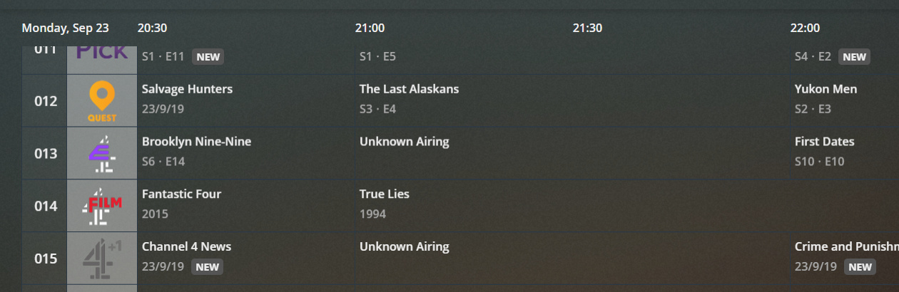

Hi @sa2000. I am seeing some ‘Unknown Airing’ slots appearing within the guide and the nature appears to be programme/time (rather than channel) specific. I am hoping to record the programme that should be appearing on E4 at 21:00 on Monday 23rd Sept, but nothing is there at present.
Guide has been manually refreshed and I am using Freview OTA South West in the UK.

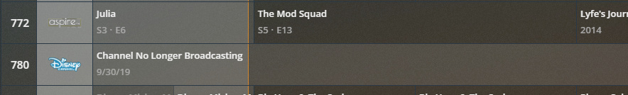

Hi @sa2000, I am seeing a few channels now that are showing Channel No Longer Broadcasting in the guide. However, these channels are indeed broadcasting, but there is really just no guide data for them.
These channels are:
780 - Disney
741 - TV Land
734 - IFC
699 - Freeform
My TV Provider is Verizon Fios - Philadelphia, and my zip code is 19002.
I’ve tried to manually refresh the guide, delete / recreate the tuner, etc. Actually deleting / recreating the tuner seems to have messed up some of the thumbnails, which I can’t figure out how to clear the cache for.

Yes - I have looked into this and we do have gaps appearing in the schedule instead of the actual airings. This has been referred to our engineering team. This can also arise if the Plex Media Server does not fully refresh the guide - but in this case - when it shows after a full refresh, the cause of the problem is different and lies elsewhere. I have opened an issue on this with our EPG team

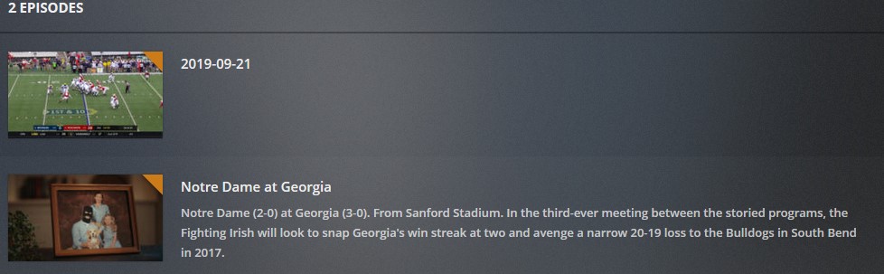

Yes that appears to arise when there is more than one game on the same day. In my tests, the use of Personal Media agent did result in separate episodes - but my recordings were all for different days.
I set my college and NFL games to record to a separate folder (still contained within my main TV media hierarchy for when it is fixed). I then created a new library of type “Other Videos”.
Scanner “Plex Video Files Scanner”, Agent “Personal Media Scanner”.
This seems to successfully break everything out and supply it with a functional title.

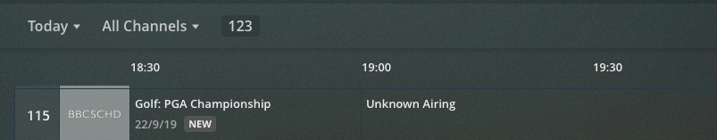

I have the same issue of Unknown Airings across the Ch4 and Ch5 channels today (22.09.19) and tomorrow (23.09.19), but it also affects BBC Scotland (channels 09 and 108) and BBC News (Ch107) across today and tomorrow as well.
I’m on Freeview STV Central OTA Broadcast.
As a side note, the guide provider still has BBC Scotland HD incorrectly listed as Channel 115, when it’s actually Channel 108. It also still has BBC Four listed as Channel 82, when it is now Channel 75.
I checked my HDHomeRun and it has the right channels listed (75 for BBC Four and 108 for BBCScotHD)
Edited at 17.30 to add: the problem of ‘Unknown airing’ seems to be spreading to ITVBe and most of the radio channels

The Unknown Airings appear if there are gaps. If these are showing up even after a manual guide refresh (through server settings) then it would be the problem I mentioned in my post here New EPG and release - #782 by sa2000
It is suspected that a recent change introduced this problem and our engineering team are working on reverting that change

I’ve tried what you recommended here. My results are better than the behavior before, but still inconsistent and not as desired. I recorded Wisconsin vs. Michigan (on Fox channel 2.2) and the recording shows up as just 2019-09-21. I also recorded Notre Dame vs. Georgia the same day (CBS channel 13.1) and it shows up correct! I also recorded and NFL game Seahawks vs. Saints today and it shows up just like the Wisconsin vs. Michigan game…just a date and nothing more.
