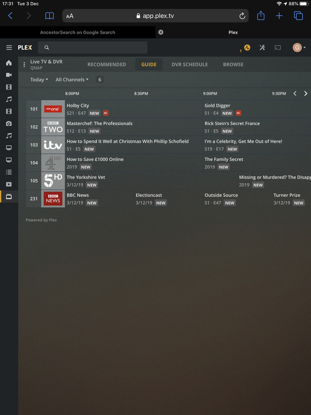

Once again the DVR is refusing to record a program on BBC in the UK - this time Holby City at 8.00pm.
From the screen shots you can see that the guide is marked as scheduled to record the program. However in the DVR schedule it is not. It will therefore not record and I am unable to force it to record. I have tried a manual reload of EPG and setting the recording to all episodes not just new. It simply refuses to set it to record.
I just had the very same problem, after investigating I found it was related to the episode number… A previously recorded episode had the wrong episode number and therefore Plex thought is already existed and would not record. Once I cleaned up the numbering it recorded without a problem. Sometimes I think the EPG has incorrect info which can really mess with your recording.
Thanks for the reply @chewmull. Could you give me more information about how you clean up the numbering? The DVR recorded an old repeated episode in the early hours of this morning for some reason. I deleted it. However, from what you appear to say this perhaps messed with the episode numbering. So how do I clean it up? Thanks
My issue was it recorded ā€œepisode 9ā€, yet E9 hadn’t aired yet. I went to IMDB to verify, then went to the directory and verified each episode and turns out I had episode 8 twice (once as 9), so simply deleting E9 was all it took. I then rescanned the library and all was well, DVR schedule was now set to record. Why did this happen? I couldn’t find a root cause but I suspect it was EPG, I was having a lot of issues with it updating and finally resolved it by dropping back a version (2029). Hope that helped…
