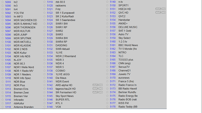

Here is the complete list of my Kabel Deutschland Kabel Digital Brandenburg channels as the HDHomeRun Expand is listing them to me:
If a channel is not marked as HD, then it isn’t :slight_smile:
The following range of channels are RADIO channels:

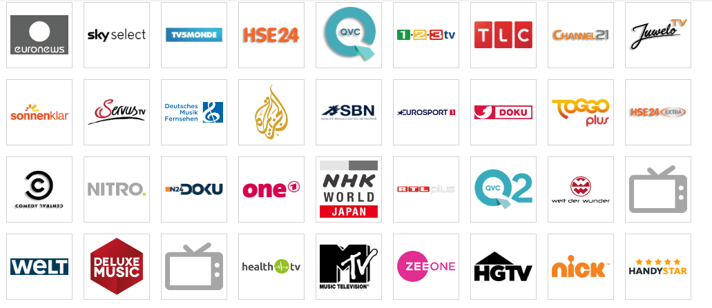

The unencrypted SD channels are:
The three channels without a logo in that list are:
France 3 (fre), France 5 (fre), ANIXE+

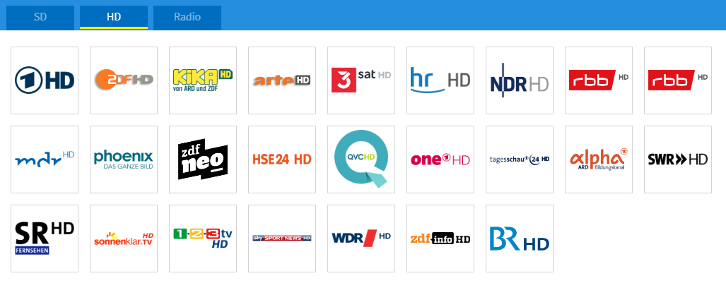

The HD channels are:
The radio channels are:

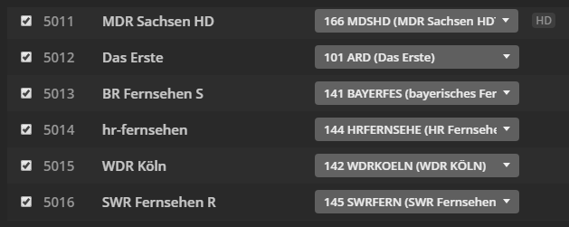

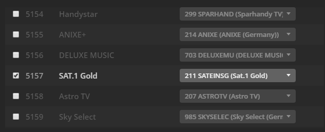

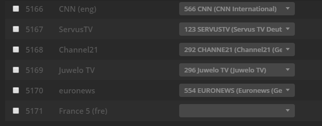

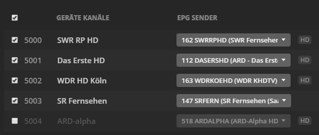

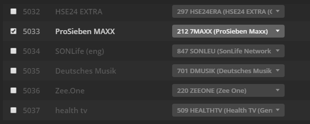

But what I can provide is my Plex mapping right now… I did not map any of the radio channels since I am not interested in recording radio. But if it can help you to identify the missing channels, the different channels numbers and enhance the Brandenburg and other mappings… u are welcome:
If the following screens show a channel, it is mapped correctly even if it is currently unticked (since I do not want to have it) - the exceptions ( not mapped correctly ) will be mentioned below each image.
In the image above, the “HD” info of channel 5049 KIKA is incorrect. It was mapped to the HD channel of KIKA before taking the screen-shot.
Here’s one of the few problems that I have the the german-wide EPG of Kabel Deutschland Digital… channel 5060 “WELT” has no mapping (or at least, I did not find one) - this channel is not to be mixed with “Welt der Wunder”.
A lot of these channels in the image above and later images were mapped incorrectly by default, and had to be re-mapped manually by myself.
On the image above, “Home & Garden TV” has no channel mapping in the chosen EPG, as well as VOXup. Comedy Central was later mapped to channel 225.
Another problem: RBB Brandenburg HD and SD cannot be mapped in the chosen EPG.
In the image above, the mapping for 5144 “SR Fernsehen HD” is incorrect, I did not find a good mapping in the chosen EPG.

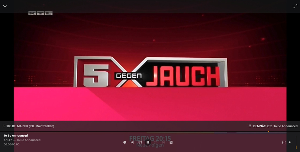

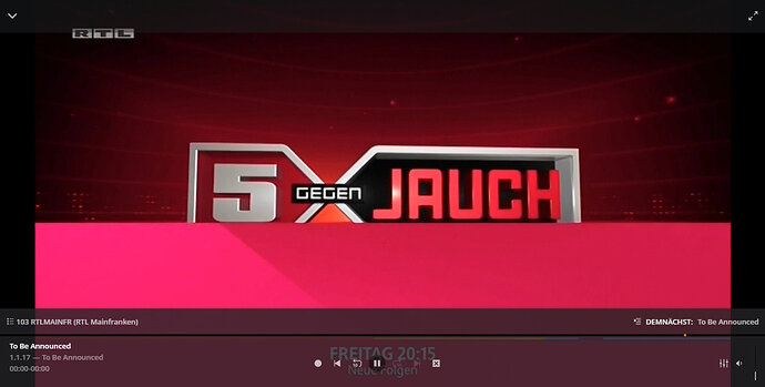

Another glitch is channel 103 (which is RTL - one of the bigger, german-wide channels).
The lineup mentioned above only has it as “RTL Mainfranken” which may or may not be a regional channel. This is WRONG. It SHOULD be “RTL”.
This channel also shows no EPG but “To Be Announced”.
When tuning into it, you get the correct main RTL channel:
Would be perfect to have this fixed and get a notification once the EPG data should be there for both channels.
